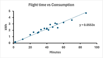

I never just fly level though so for more detail, here’s a graph of my flight time vs power consumption across 20 flights with the V2.5 battery, showing that my average power use mid flight is 3.3kW.
