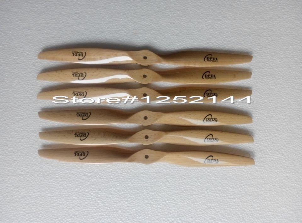

Thanks, I am going to try these for $75 (4 props)
Looking forward to hearing your analysis on these. This topic has come up a few times but nobody has reported on actually trying something different. In a previous thread the comment was made that if the pitch is too high while flying slow that the blade will actually stall. I don’t think this is happening but your test will be interesting to many of us.
It looks like the props you found only have an 8mm hole and I believe we use a 10mm shaft.
These ones say they have 10mm holes. If you ordered other ones it’s easy enough to drill the holes larger.

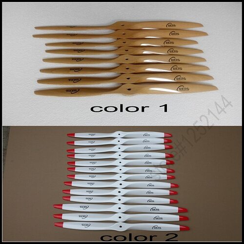

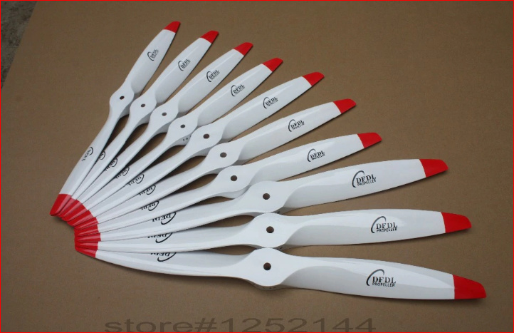

I noticed your white props in another thread… are those the 8 inch pitch? It would be nice if you would test them with 4 batteries as a comparison before you convert to 6 batteries. I would love to hear a true side by side comparison.
Those white ones are the same as the other post. They are 22x10, I am still waiting for 22x8 to come from china to compare flight times. As soon as I get them I will test and post the results.
Are they the ones that came with the kit? Did you paint them white?
