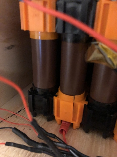

Update, after 8 flights I noticed major cracking in many of the vruzend caps. I got some of the first batches of their v2.1 caps and they found that this was a flaw in them, vruzend since changed the polymer mix now so they are stronger and are sending me replacements which means i’m going to rebuild my pack. This is okay because I want to make some changes.

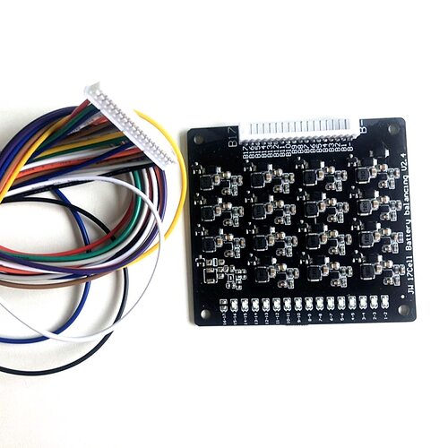

I also cannot get the pack to charge to full capacity with our bms, one group of cells always hits the 4.2v cut off before the rest, leaving the pack at 58.1v charge usually and it refuses to charge to full 58.8v capacity. Adding this active balancer is a must for our lithium ion packs if we want to use it’s full capacity. I am going to install it in conjunction with the BMS. They can work together separately to balance charge the pack to full capacity. It’s also from what i’ve read much easier on the cells, a bms will balance charge by dissipating the higher voltage cells in the form of heat, where as an active balancer uses the higher voltage cells to charge up the lower voltage cells.
Here’s link to the one I ordered.
My next winter project is to use an active balancer on my Lipo’s! If I understand it correctly this one
will work at discharge with 2A active balancing. It has super capacitors and uses external power…
If it works it will extend and increases system run-time!

I thought about something like this but I don’t know if 2a would be enough to actively balance during our high discharge rates. Even in cruise we are pulling 130-150amps, so I’d be very surprised if it could keep up and balance the cells during discharge. From what I’ve read they are quite slow to balance the cells which is why it’s mainly for charging and not discharging. This would be good for something that has a slow draw of power off a battery pack and would keep the cells balanced.
With 2A it should be able to equalize a 5% difference of one cell within 15 minutes…
They are available with 1, 2, 5 and 10A active balance charging. This is why you need a
external power source. Other active balancer use the power from the highest cell and
can charge maybe max 1.2 A. Since I have 4 x 6 Cell Lipo’s it could work out… With
lipo’s there is a problem that only one cell from 24 discharges quicker and you have
to shut off all power to save the lowest cell.

The active balancer won’t do much in flight. It will be too slow to transfer that energy.

An update. So I got about 4 flights on this pack last year after noticing cracks in a lot of the vruzend plastic caps. Vruzend sent me a new version of the caps saying they changed the polymer to be stronger. So I rebuilt the pack this winter, now noticing the brand new caps to be cracked as well, the battery has not moved off the workbench. So there is obviously something wrong with the vruzend caps. I think I’m going to abandon them and switch to lipo packs since I just don’t have the time to figure out how to build a spot welded pack and I’d rather just get in the air.
