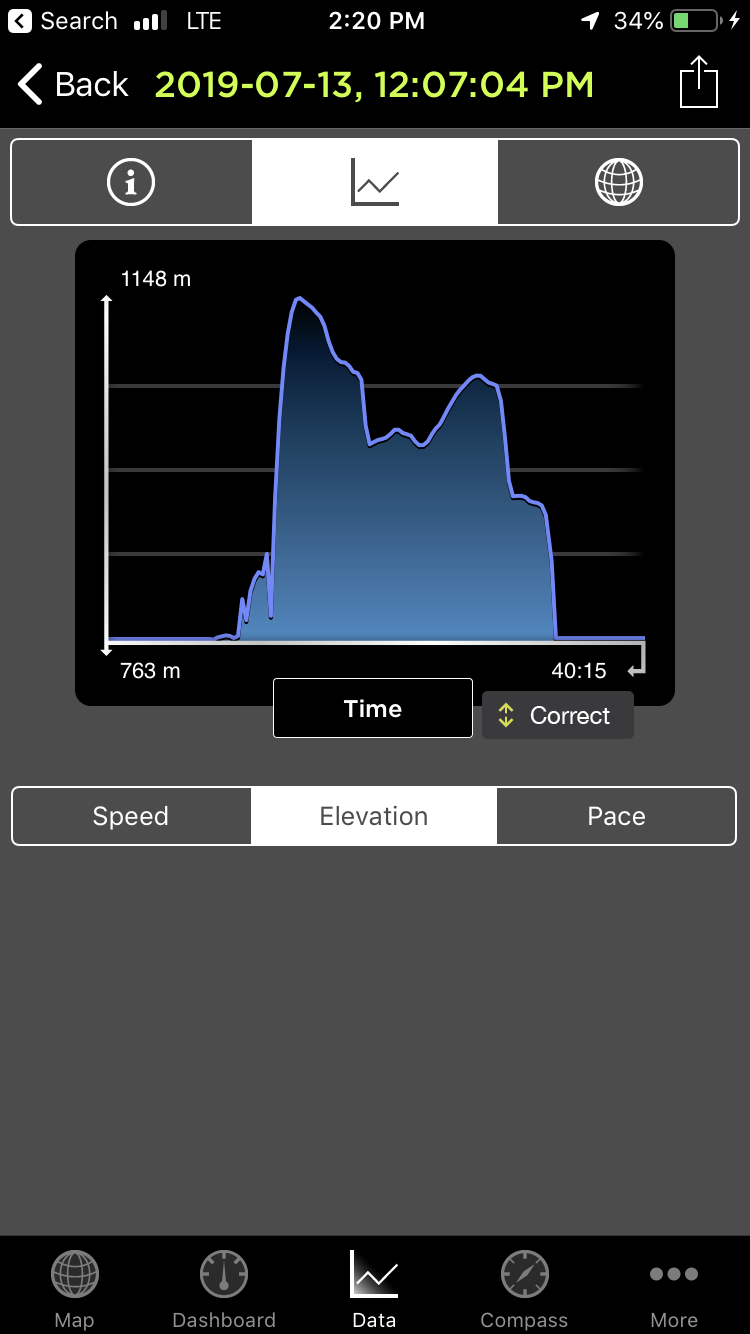

Had a good flight today on third attempt. First two tries I climbed up for couple min and the BMS hit 60° and cut off power. One landing was in nice yellow canola field. Lucky no damage and good landing. I had chase cam on so will share that video. After setting bms high temp cuttoff to 80° I had excellent 30 min flight. Temp is only an issue on take off. During cruise temp was 45°c. Only light lift so mainly on power the entire flight. Start voltage 56v end 44v. One parallel group of batteries dropped to 2.5v cutt off with power on and the bms shut power off so that’s why I didn’t fly longer. All other groups were around 3.15v and the one was 2.8v. Glad I have the bms to save the cells.

So I’ve flown quite a few times with this battery now. Couple things ill want to change? I think I should put the bms on the bottom instead of the top of the pack so that it stays cooler, I’m also wondering if I should go with a thick copper bus bar to take the power from the pack. Reason, I’m not getting to utilize the full power available from pack, the last group of parallel cells drop much lower vs the centre cells. I’m not sure if it’s the positive or negative group of cells that are low but it’s either one of them. They will hit 2.8v while the rest of the parallel groups are still at 3.1v. Does anyone have any other suggestions as to how to combat this variation in voltage?
I’ve had some issues where the end parallel groups that I take the power leads from are lower volts vs the centre cells when i’m flying and they hit the 2.8V cut off much sooner then the rest of the pack. I talked with Vruzend, they recommended to
take power from each cell to reduce loads on the cells as well as decrease the high temps i’m seeing with my BMS. So here’s the modification i’m doing to the pack.Flew today, the mod to the battery definitely helped keep things cooler, the BMS was only 25ºc during cruise, got to 55 on max throttle, before this was about 75ºc on climb and 40-50 in cruise. But still ran into issue with one group of battery dropping lower then the rest, this time closer to the middle of the pack. Any ideas why this is happening? I still have plenty of power left in the pack after 30 minutes but can’t use it due to the one group of cells getting lower then the rest…maybe it’s bms setting but I didn’t think it would be capable of balance controlling the voltage during discharge.
