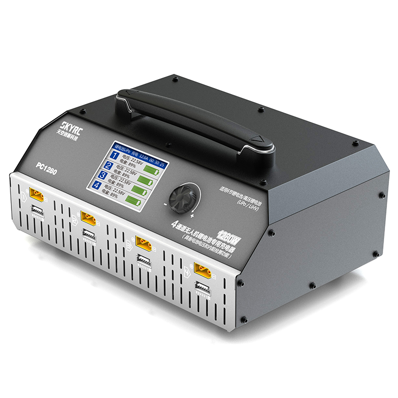

My dream is to have 1 charger that plugs into 1 wall socket. That charger will have 4 channels with 4 balance boards. That charger will monitor all cells in all 4 batts. that charger will also discharge all 4 batts at the same time.
Buying another 2 batt charger is the logical decision.
However before I spend another $300 on another 2 channel charger
is there a charger that can meet my needs?

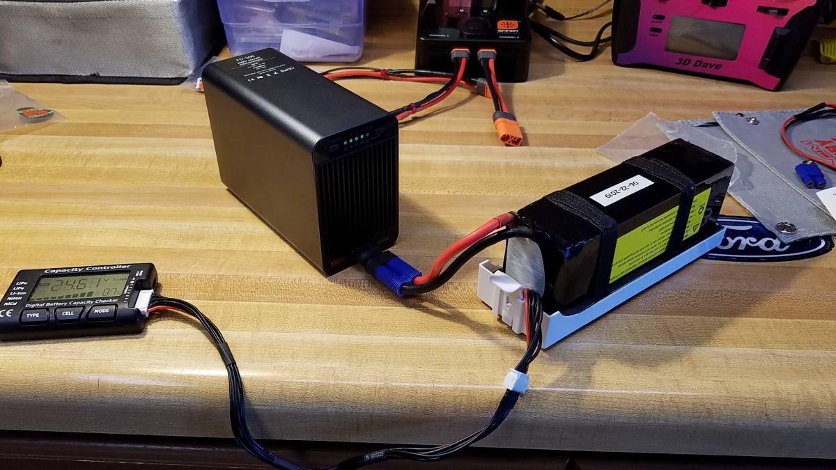

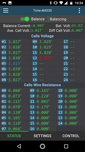

Meanwhile I bulk charge or discharge only, since I use two 1A active balancer.
Incredible how much more effective and faster the active balancing works instead the passive balancing from regular chargers.
The active balancer needs 90 seconds to balance 0.1 Volt difference from cells since it discharges the highest cell’s and charges the lowest cell instead discharging all cells to the lowest cell’s voltage. I will
install them fixed to my battery pack since they work as well under load and occupy only the balance port.
