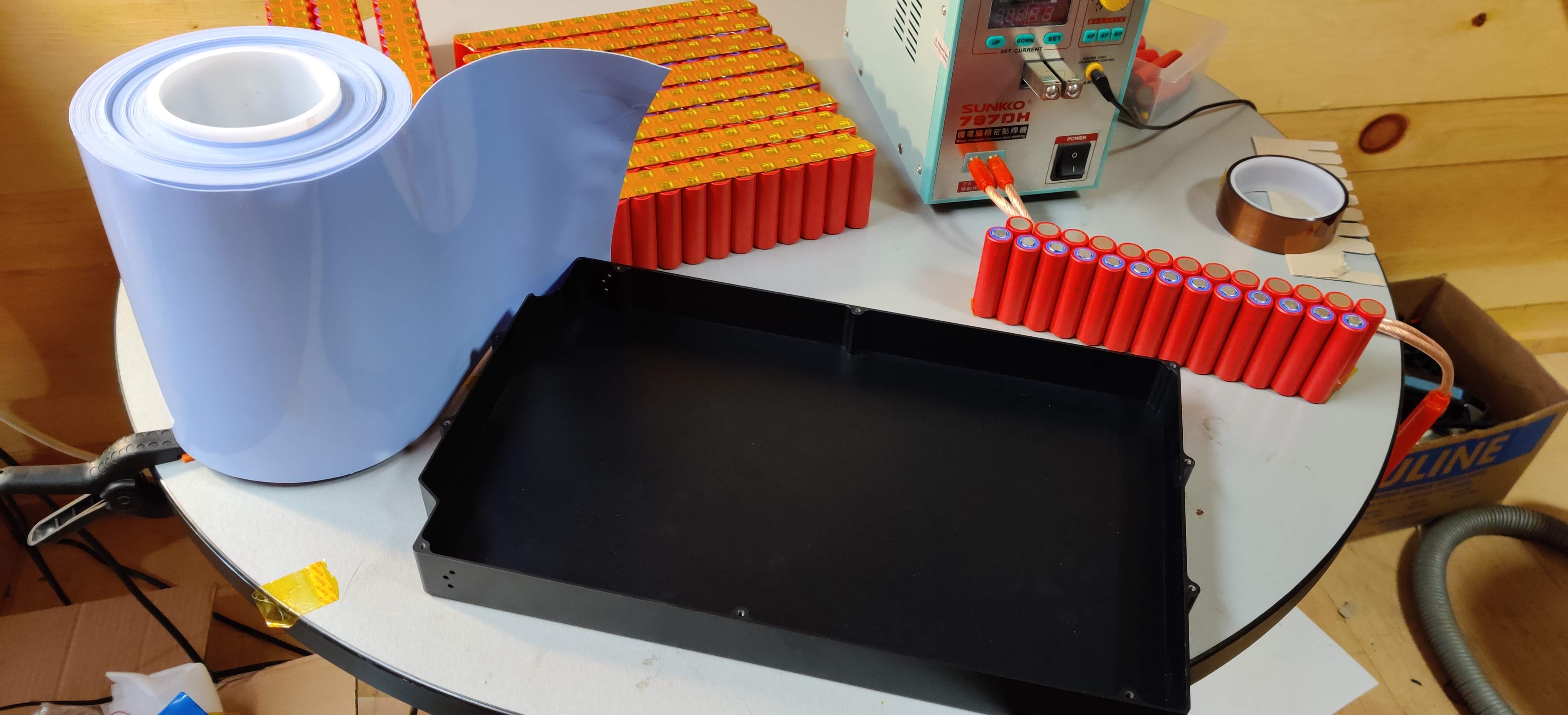

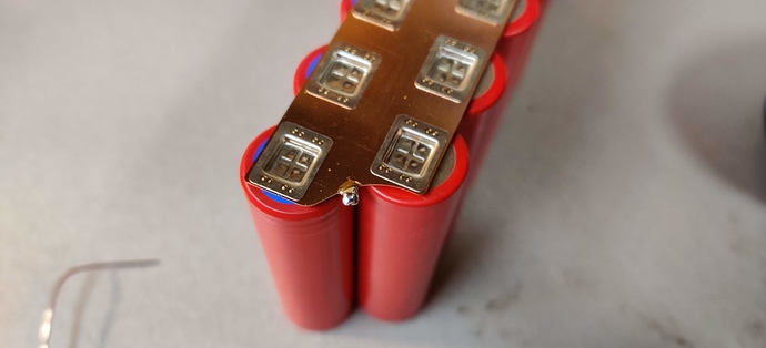

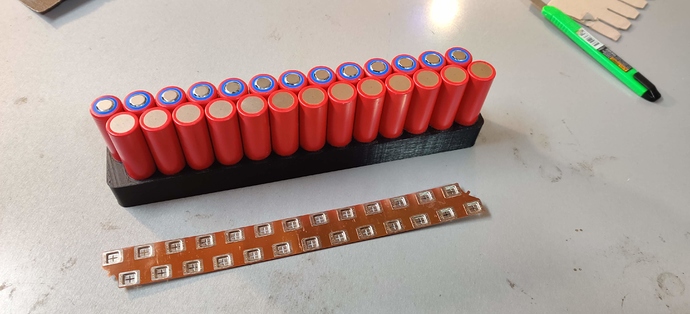

Or if you need battery making supply or cells, i got every thing you could need to make a pack of any size.
I have the Cells, if you have a case, BMS, cell tabs and some heat shrink and a connector to build a pack for the SP140 Let me know how much, you can ship with the SP140 I have on order.
