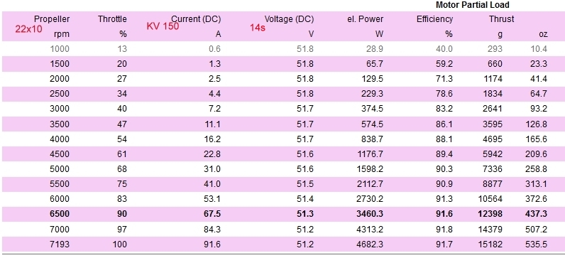

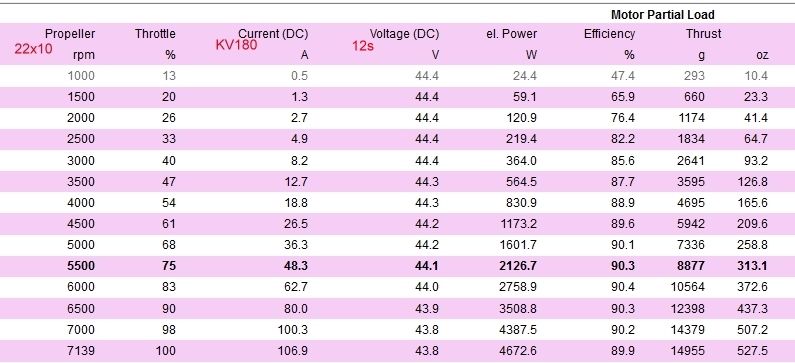

I just tried to figure out how the new 150 KV motors will work…
This is the original 180 kv 12s version:
This is the new version 150 kv 14s:

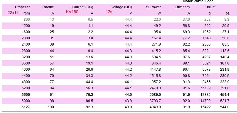

And this is the 150 kv 12s version - looks like they have to use the 22x14 propeller:
There is a possibility that the 150 kv 12s version with the 22x14 props will be more silent and more
effective… Maybe we need then really the 100 A ESC’s!!!
If you want the higher pitch it would be best to lower the kv even more and stick with 14s. I agree the higher pitch would be more silent because you could use lower RPMs but not sure how that would effect efficiency. There’s been a lot of talk on hear about using less pitch to improve efficiency but it’s all been just talk because nobody has actually tested and reported. Lower RPM would reduce tip vortices but higher pitch would increase them so I don’t know which way the scales would tip here for efficiency.

22x16 props would be theoretically great, but they will have prop stall with this huge pitch and
need a lot of torque power as well!
22x14 with KV180 12S could work if you don’t go over 80% throttle or you burn the ESC’s!
