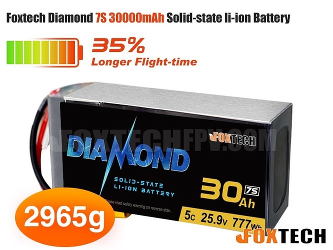

https://www.foxtechfpv.com/foxtech-diamond-6s-22000mah-semi-solid-state-li-ion-battery.html
Now also 7S version available from the Diamond Series Solid-state Li-ion Battery.
Interesting for the 150KV versions of the X4.
Is there someone that have tested the Solid-state Li-ion batteries and compared them with the Bonkas in real flight? Did it result in longer flight time?
RichardG was testing the Foxtech batteries at 150 A. Someone else reported that their full-power climb would draw 300-350 A. So simple math would demand that at least two Foxtech batteries be connected in parallel just to handle operational loads. Three would be better, and thus each battery would be required to supply only 100-120A under max load. Am I mistaken? And wouldn’t this configuration yield 90 Ah, or still only about an hour of flight time presuming that the average current draw was 90 A? Thus, if max-power climb consumed 120 A for 10 minutes, then the remaining 50 minutes of flight would have to consume no more than 60 A (actually, 58.3 A). Is this a reasonable expectation? Or would we wish to, say, double that capacity? What was the weight of those batteries again? Maybe it’s not terribly unreasonable if one can afford them.

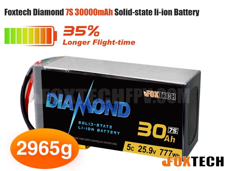

Btw, I notice on that Foxtech page, they now say they have a 7S battery with 30,000mAh @25.9v for $669

Bonkas are $250 for a 7s 22Ah that weighs 2500g - 1.13kg/ah and 11.3 dollars/ah
Foxtechs are $670 for a 7s 30Ah that weighs 2965g - 1kg/ah and 22.3 dollars/ah
If they have the same punch as the Bonkas is the slight capacity/weight advantage worth double the price? Not for me. Also I’m thinking they’ll actually perform about the same as the Bonkas in real world. They’re trading that “C” rating for capacity I think.
It’s important to remember that the Diamonds are supposed to have much, much better safety characteristics. If it’s true that they’re hard, if not impossible, to abuse to the point that they catch on fire, the equation changes to:
Is it worth spending double the price to have a similarly performing battery but with minimized fire risk?
To me, having seen the damage wrought by lithium fires, it’s an easy choice.
They’re the same chemistry and form factor. All LiPos ‘vent with flame’ when they get overcharged overheated or punctured. I see they have a thin aluminum side plate to help prevent impact/puncture damage. They may have some type of built in overcharge and/or overheating protection. That could be worth the extra bucks for you. LiFe (round cells) are more robust and are also way cheaper but you’d would have to either custom source a 16S X 14P pack or build it yourself from over 200 cells and some connector system. That sort of negates the cost savings but LiFe will have a much higher cycle life. This is something I’ve been seriously considering. Esp if I can find a deal on 200+ LiFe cells.
