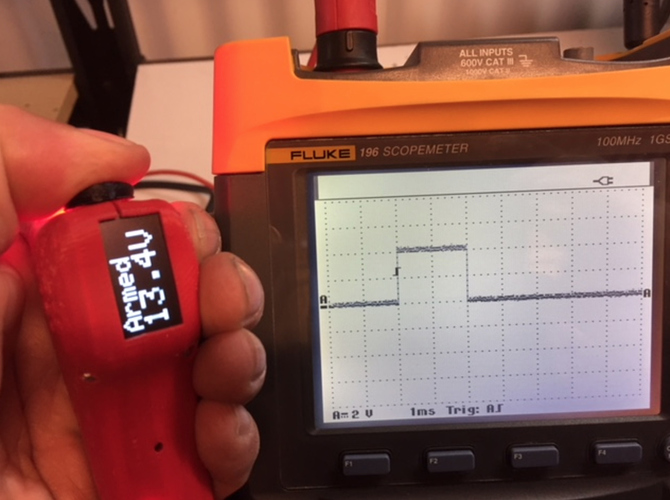

The range of PWM (go signal from throttle) is quite wide - more so than my servo tester so I did a throttle calibration. The response range now seems better.
I also changed the ESC timing to HIGH. The motors now run much smoother through the throttle range. None of that ugly resonating (phase mis-firing) that was happening at mid throttle on the INT default setting.

Yes. All 4 ESC’s done at once. And yes. Throttle range calibration as described in step 2 of above linked document.
The additional 5v power is artificially injected into throttle/hand-switch. It needs to be powered up, armed and at full throttle BEFORE the main power is supplied to the ESCs. Listen for those beep codes then release the throttle at the appropriate time. No programming leads or re-plugging of the ESC’s needed.
Try both of the timing settings and go with the one that SOUNDS the smoothest throughout the range. I’m curious to her other feedback.

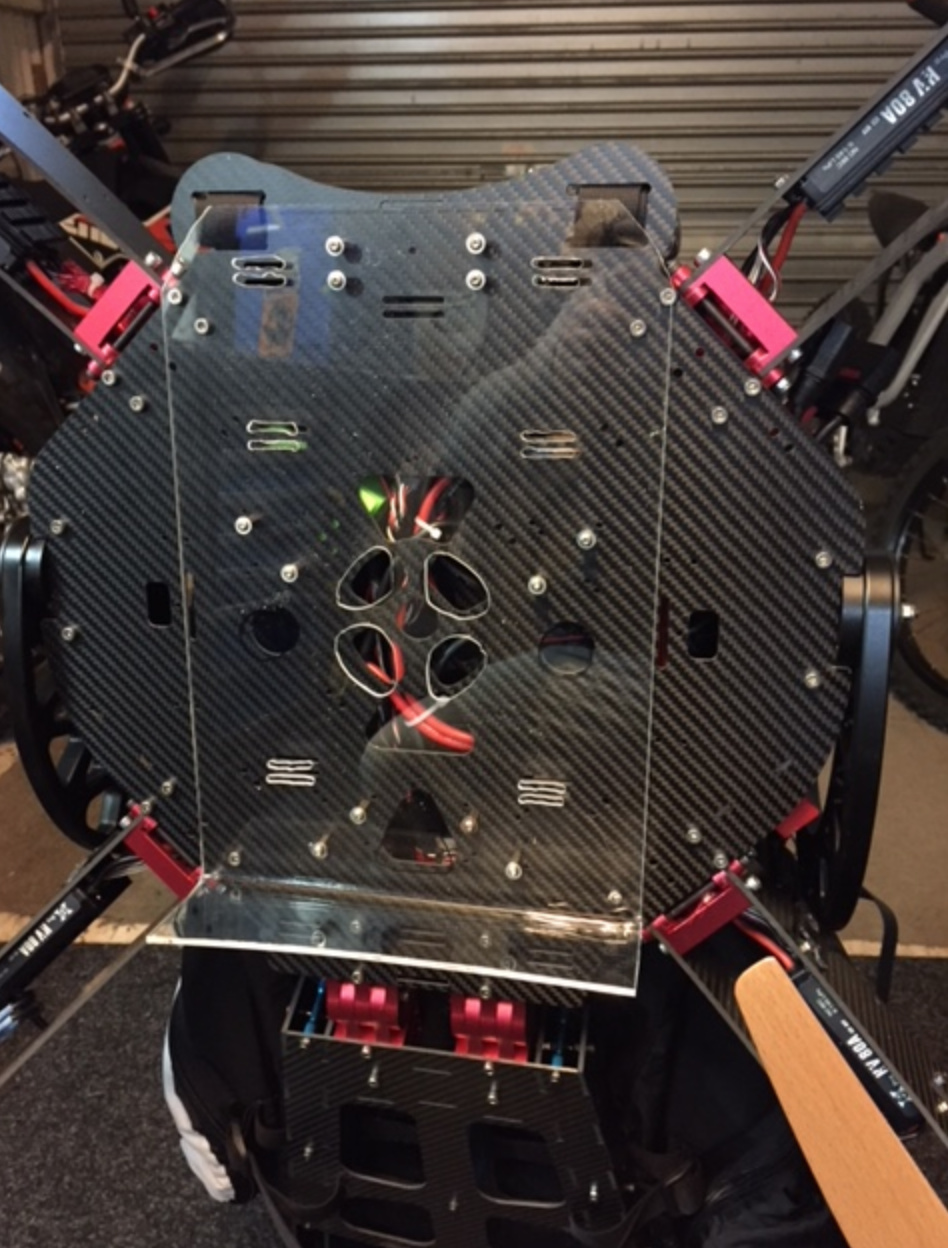

Here’s another idea I’ve been working through regarding attaching the batteries to the frame. Lets see what breaks first…

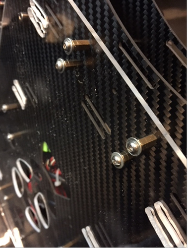

3mm Perspex riding on 10mm brass stand-off’s, screwed into the 35mm stand-off’s inside the frame
I plan on using sticky velcro on the batt’s and perspex. Also Velcro straps through the frame to lock it all together.
Hoping to make field assembly of the battery a bit easier.

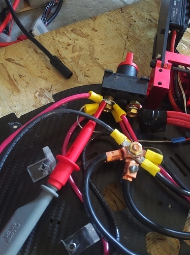

Is the concern about that bus bar in particular or the concept in general? Theoretically, I don’t see a difference between a bunch of wires soldered together and a bus bar connection. I could, for example, take some 6 or 8 awg wire and solder the power lines to that. Effectively this would be a bus bar. Why would a solid metal bar be worse? I would think a wire would be worse conductor. Would a rated bar eliminate the concern? I spotted a 48v 600a rated bar online though I have no sense of the scale to decide if it will fit.
So I started with the bar config, and I think it’s unnecessary. I removed it and when back to a a group of ring terminals crimped to the wires (and soldered) and all bolted together. Lighter, lower resistance, simpler.
I would think a thick copper bus bar would be less resistance than a thin terminal ring.
Have you actually flown it with the ring terminal bolted together? Can you post a picture of your wiring?
Yup just got back from a 17 minute flight on this config. Also have done strap down stress testing. Zero heat on the GND connection. Some heat on switch, but I believe that’s caused by switch, not connection.
