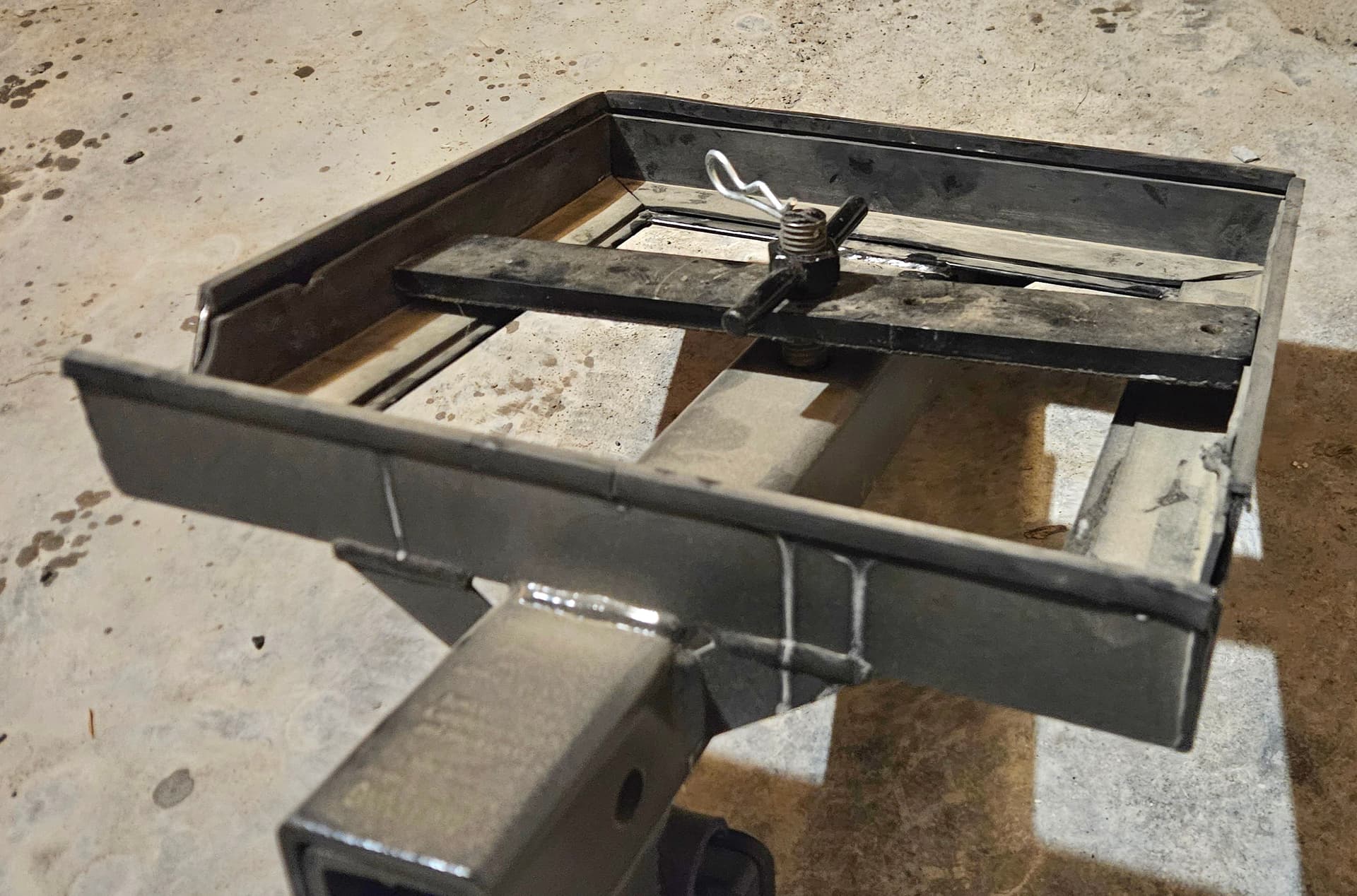

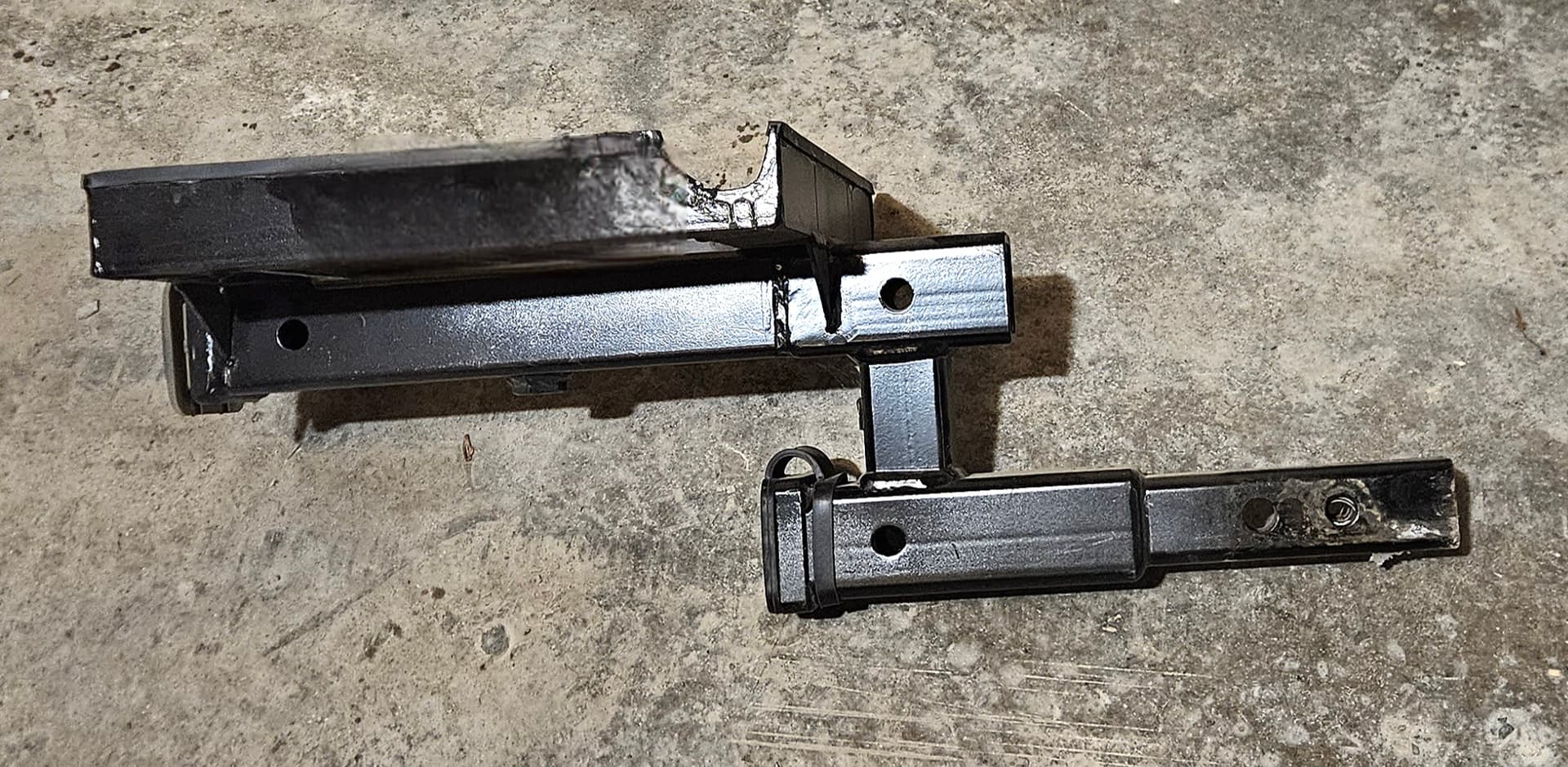

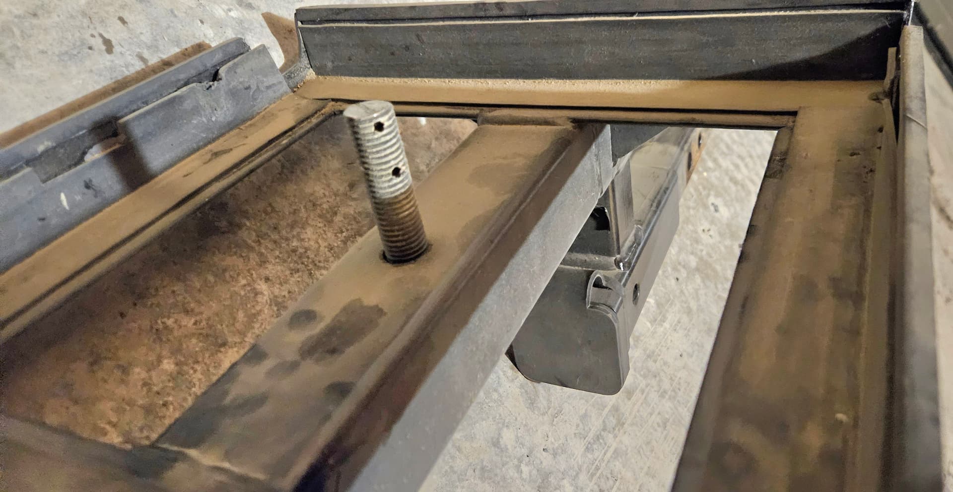

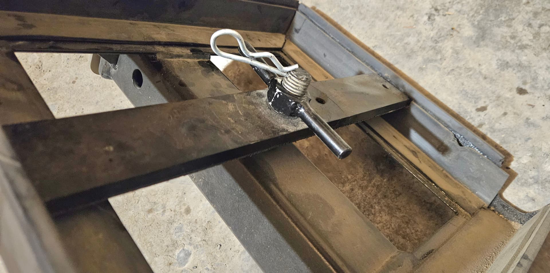

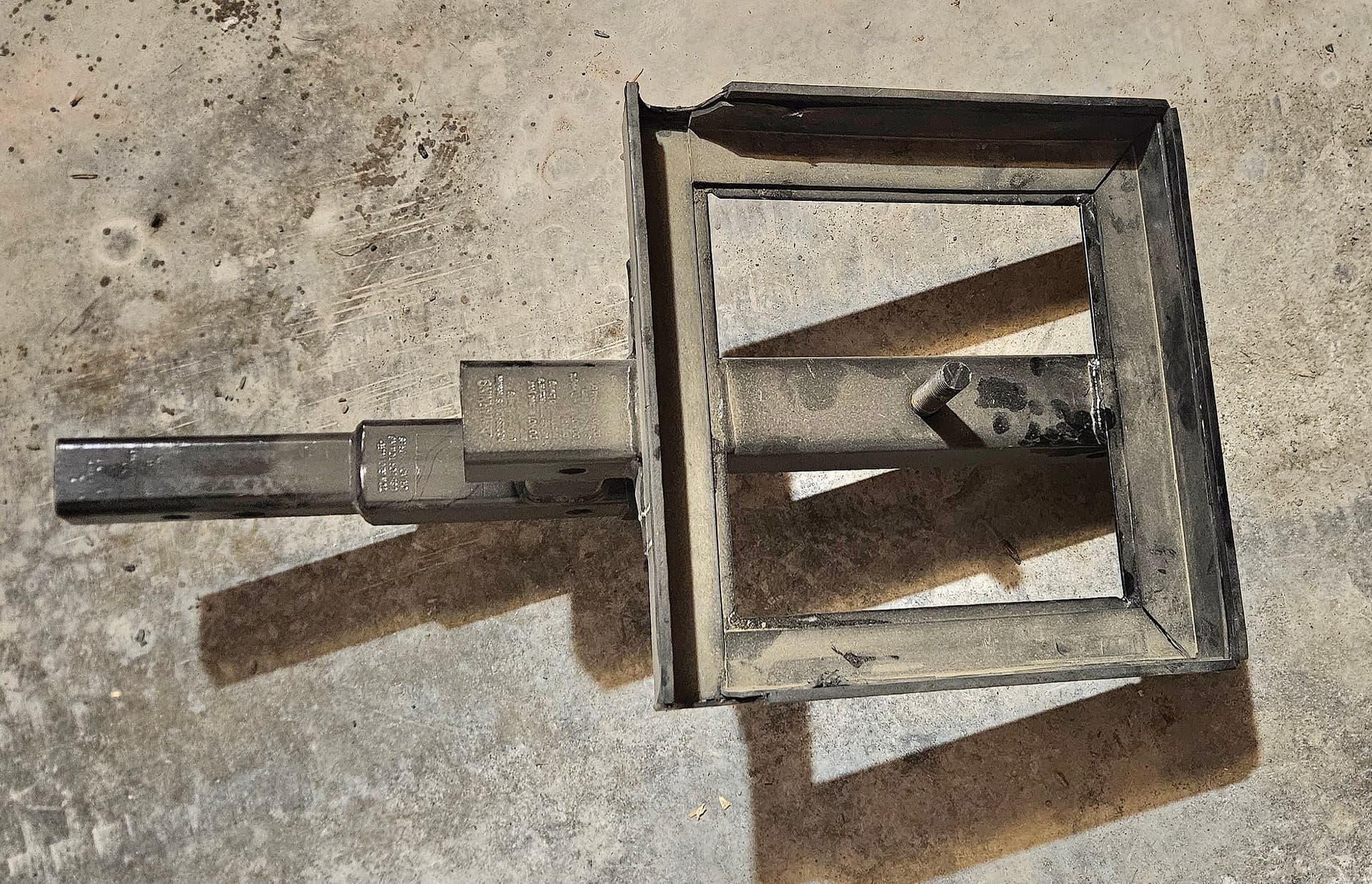

Would you be willing to post details on the hitch mount?
I’ll take a few photos of the hitch setup I built and post them for you. I’m not saying it’s perfect, but so far so good. It’s solid enough for traveling, cost-effective simple to use and pretty quick to install.
Do you also have a cover? Or do you just use the ole ‘bbq grill’ cover hack?
“I don’t have a cover, but I used an air gun on my compressor whenever it got dusty. Right now it’s the off-season for me — snow on the ground, too cold out there… and I’m too old for that sh*t below zero! lol
Back when I was flying with a gas paramotor in winter, though, I had a custom-made cover because of all the salt and sand mist when driving.”
Thank you! I wish I had your welding skills!
Doesn’t need much really…just a good neighbor! :sweat_smile: I made my plans on paper, cut all the pieces and he helped me to assemble the puzzle.
If you brake it down, the 2” beams are two regular hitch parts that are weld together. After you just need the to fix the sitting bed on the top of that..et voilà!
I’ll try to take pictures or a videowhen it’s mounted.
