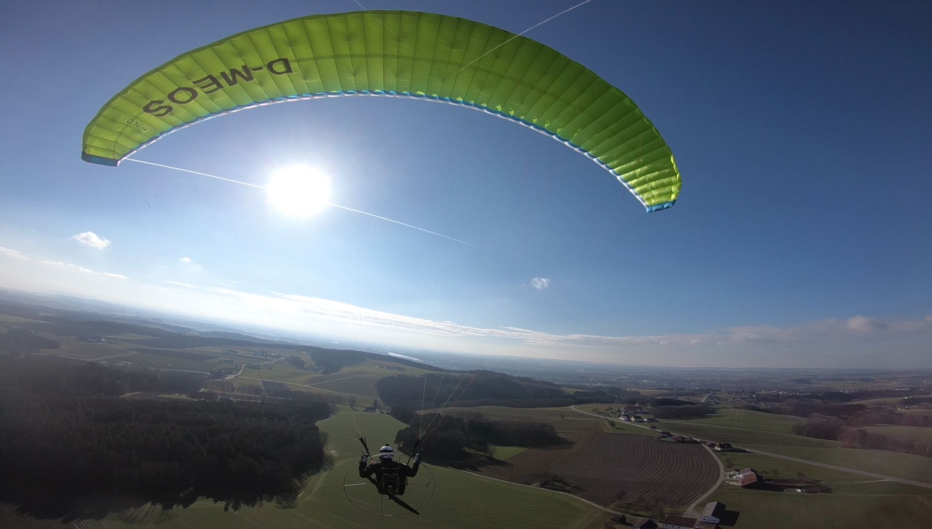

hello, if someone wants to allow his own built flight unit for himself in germany this is possible via the DGAC - fiche solution. The applicant then fully liable for his device. it is registered with the dulv as ultralight aircraft. One of my flying machines is registered and insured with the DGAC solution.

You need a wing with dgac. The wing manufacturer must fill in the fiche with the serial number. There are a lot of wings that have the fiche. also very good for electric flying such as. the ion 4 of nova. or ozone and many others. the fiche you send to the dulv as well as the applications and other papers that you can request the dulv by mail. The license plate (M - ⊠for Ultralight Aircraft) as well as the insurance you can also apply for the dulv.
