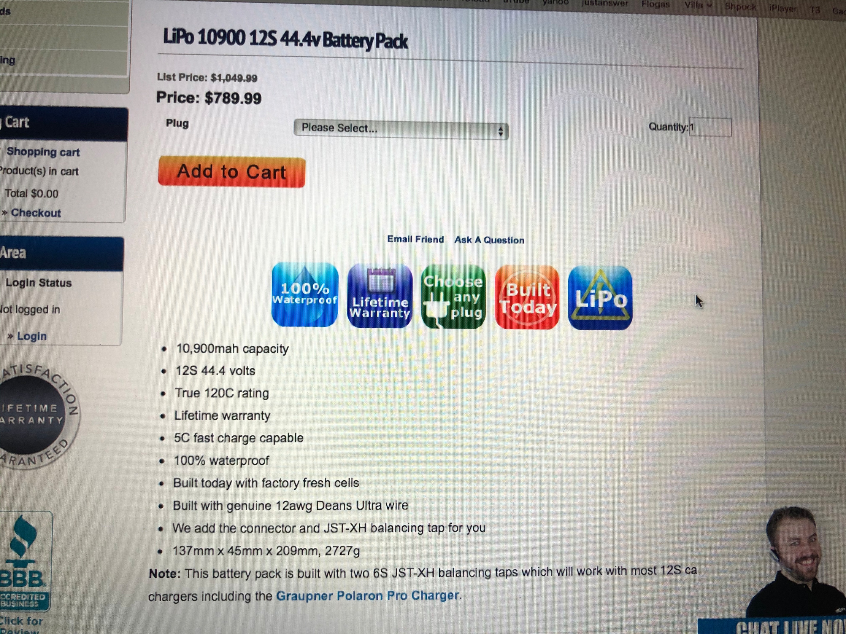

Hi. The 150c batteries are 12s therefore 44volts so surely you could have 3??

Agreed you should be considering the C rating, but it should be treated as the max current draw, so for continuous you should be staying well below. It’s basically a rating of the internal resistance.
So for the openppg from what I’ve read, max climb is 80A per motor, x4 that’s 320A. Let’s say you are happy with 10C draw at prolonged climb. 320/10=32Ah
Really you need some temperature measurements of the batteries under different loadings. I wouldn’t be happy for the battery to go up by more than about 5-10degC. Because the batteries are quite large, the temp in the middle could be a lot higher than that.

You are right, did not see the 12 s …
You could ping the supplier or manufacturer of that 12S battery to see what they recommend as continuous current draw.
Do you expect to do prolonged climbs or mainly level cruise? Also what is your weight? Those things will make a big difference to current draw.

Thanks for contacting us. I’ll be happy to assist you with determining the best battery solution for your desired flight goals. I assume that you will be running the two packs in parallel for a 12S 21,800mAh power setup? If so, then a 320A discharge would only be about a 15C discharge rate which these packs should be able able to handle efficiently without any over-heating issue with the cells. That makes these packas a good choice opposed to packs that would be pushed to the max. The key to avoiding heat resistance at 320A will be the wire gauge and connector being used. They need to be rated to handle that load without getting too hot.
What connectors and wire gauge are you using on the Flight system side?

regarding the 10900 12s: I am considering 2 of these for openppg paramotor: this would require 320amps continuously for 5 minutes (for a prolonged full power climb). do you think these could handle that without undue overheating? obviously I would like to avoid any risk of fire while flying! Is there any data you have to test battery temperature rise under high loads?? thanks.
I’d be worried about the 12 gauge wire on these batteries, that’s thin for pulling 150 amps (if your running two packs).
