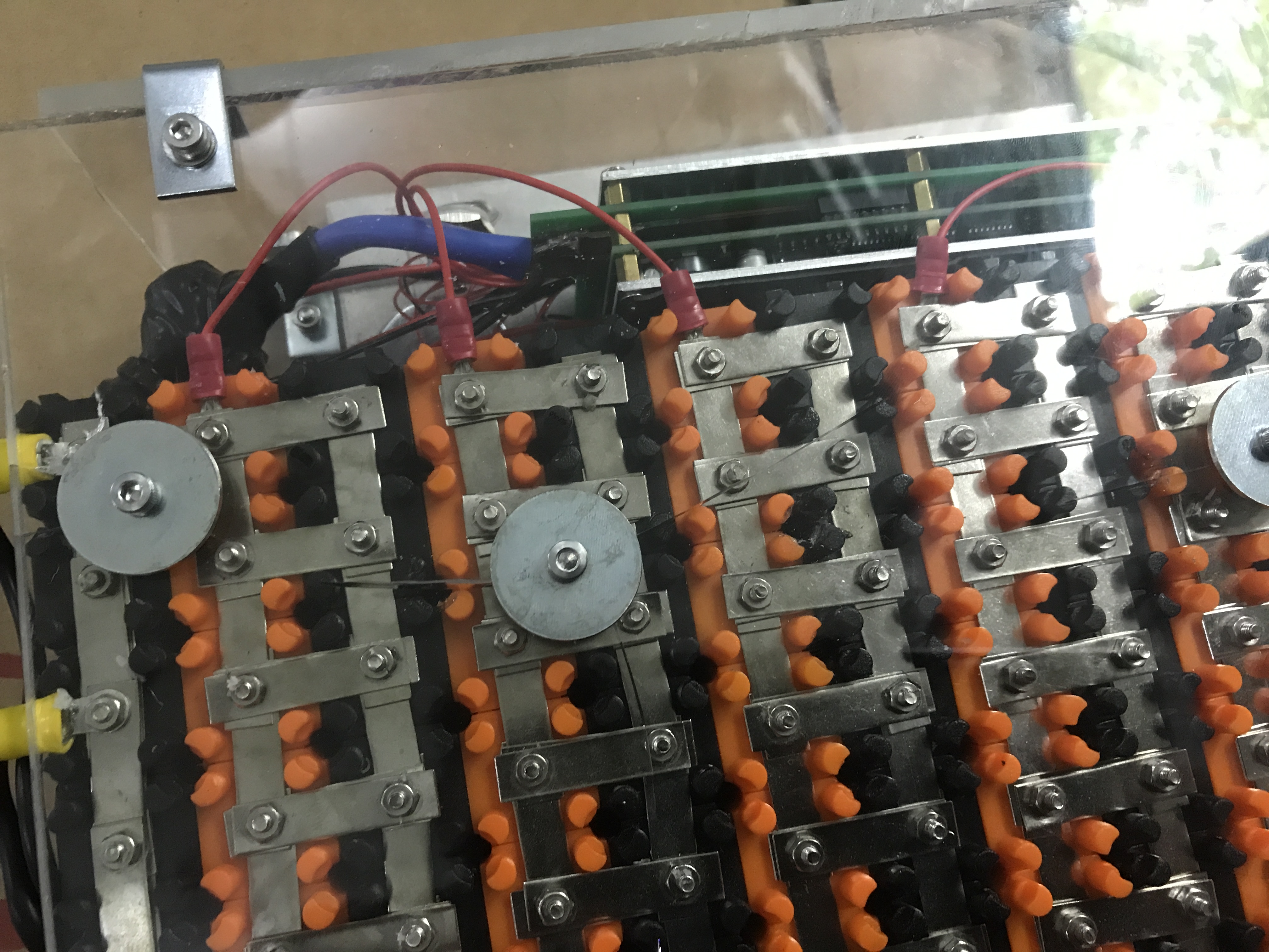

I need some advice from you all. I built the case out of acrylic but as you can see after doing a couple test runs on the ground the case has cracked like crazy. My question is what should I use? I can’t use anything conductive. I’m thinking about lexan or polycarbonate which is supposed to be stronger and much less prone to this happening.
Was planning to fly first flight tonight but I think I need to make new side pieces as this is how the battery is held onto the paramotor frame.
The only thing acrylic is good for is picture frames and display items. Polycarbonate will work really well. Lexan is a brand name for polycarbonate.
Appreciate that Paul. I didn’t realize acrylic was so brittle. Now I know why Aircraft only use poly/lexan.
