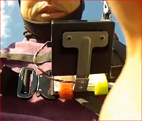

My idea is to put it on a flight deck or directly to the harness like here…

looks interesting - how is it in the sun
The bat temp is a good function but unless you and monitor all the packs, not sure it is practical.
Did you make the mount yourself

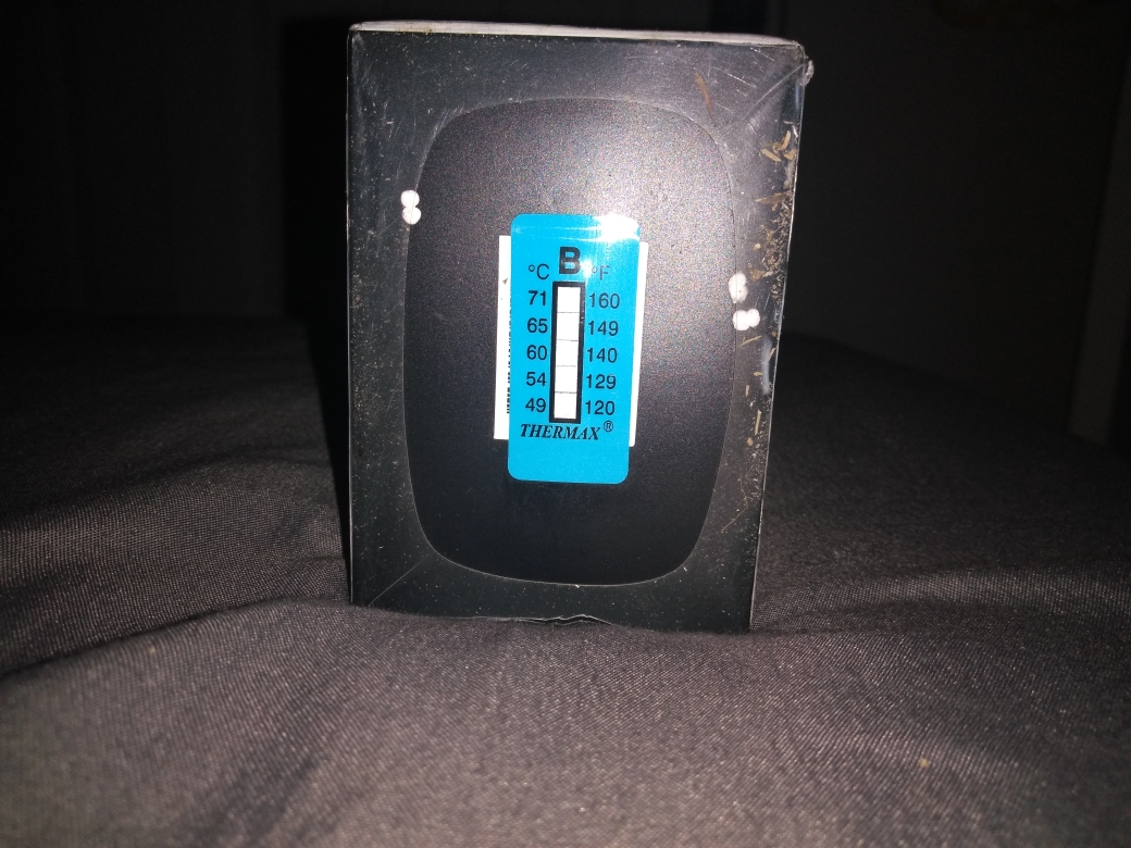

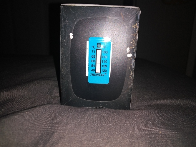

I put these as well on every battery pack:
https://www.ebay.com/itm/Thermax-Temperature-Strip-Labels-Range-B-Level-5-120-160-F-49-71-C-10-pc/162523452872?hash=item25d72715c8:g:3eEAAOSwurZZIOG1
I will report back in the future how the temp probe worked out…

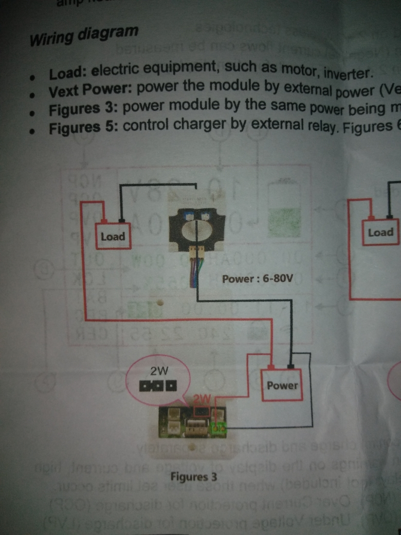

Hi do you have some wiring diagram for this device . Just bought one but no diagram .
Thanks

Thanks a million . It´s working very well.
Regards
