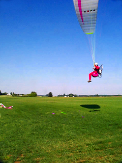

This photo shows my “Bug” to the right next to a standard size gas PPG at the time😆
One of my ideas - the mini frame was integrated into the harness and any motor could be attached to it as long as the PPG weight was not going over 22lbs to prevent the motor from tilting back and the thrust pushing towards the seagulls - 19cm medium density foam back protector inside the harness.
Me with a 19lbs PPG
Warming up on its own. We even already had a remote control throttle but the response was too slow so we gave that up at the time.
Note that there is no side bars - the risers were directly connected to the PG main carabiners.
Myself with a friend with his Mini-PPG as well, thermaling - I am on the left.
Two Minis

It was a long time ago. Something to remember is that the weight of the PPG cannot exceed
20 to 25lbs otherwise it would tilt the cage back and the thrust will be pointing toward the seagulls.
I used harnesses made by SUPAIR at the time.
Gas Boxer engine
Hard to see on the photo but my mini PPG called the NewTron, had a rectangular PVC frame. It was inserted inside the dorsal storage pocket of the harness really tight.
