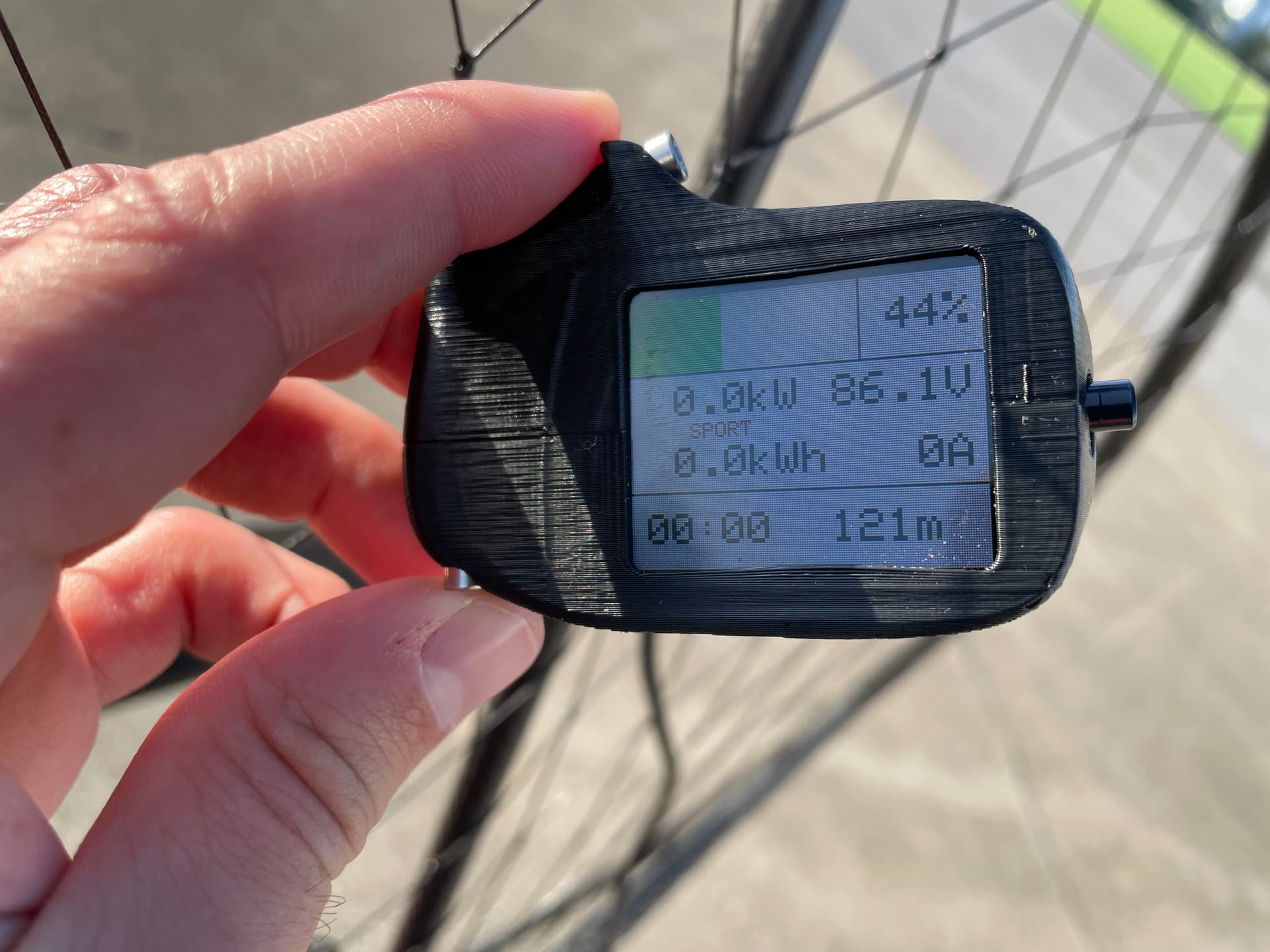

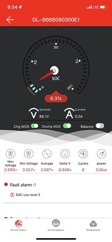

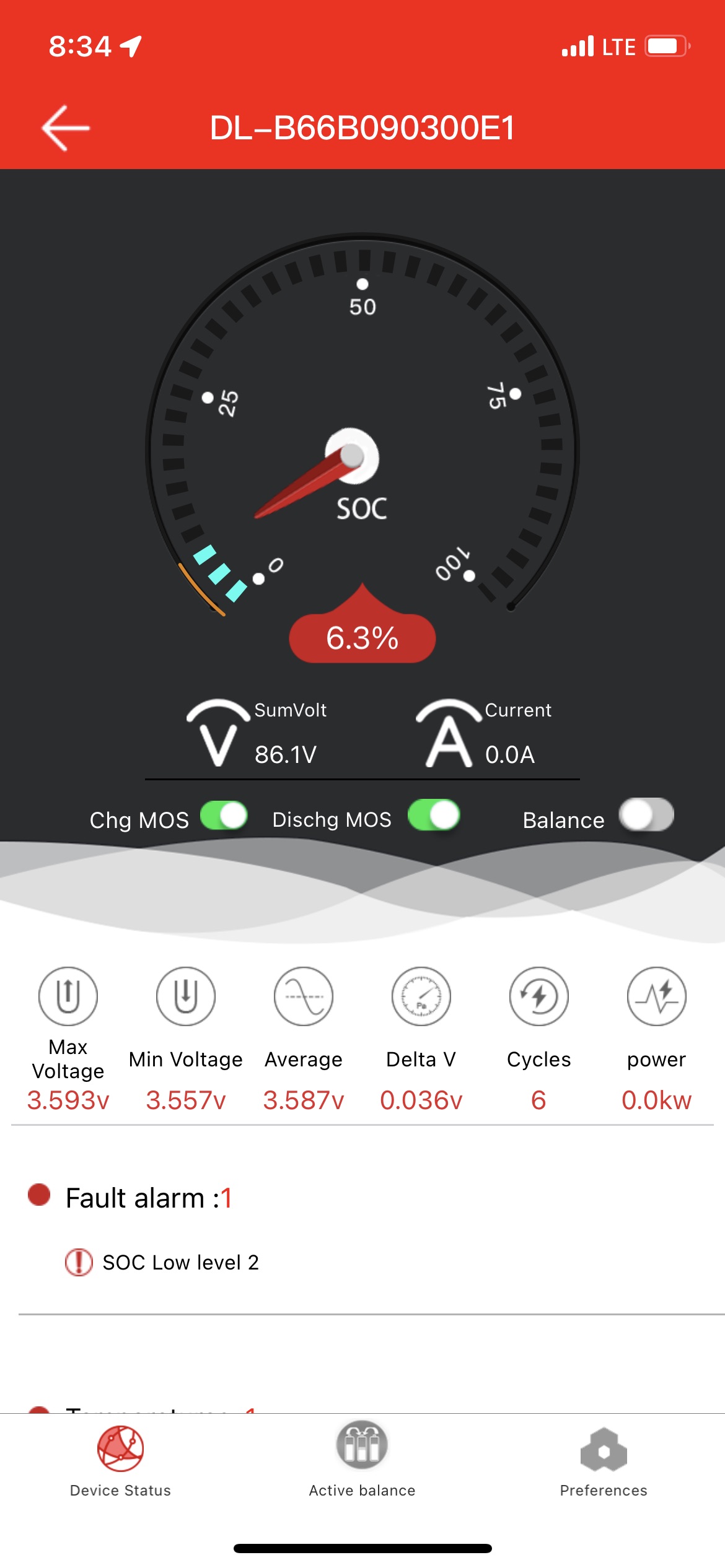

I’m not sure why but the power remaing on controller is reading 44% and the BMS app says only 6.3%. This in only after 31 minutes of flight on a 1hr battery. Not aggressively used during flight and this is a new battery. Does anyone know what could be happening? Here are pictures comparing BMS app to controller readout.
The BMS needs to cycle a few time to calibrate its SOC.
Ok, so the battery isn’t actually at such a low percentage as shown in the app? In this case the remote is more accurate? I’m just struggling with knowing what to trust here as a good indicator for safety.
Ya best way is just to look overall voltage and cell voltage. Ya looking at the hand controller is best till your battery calibrates more.
