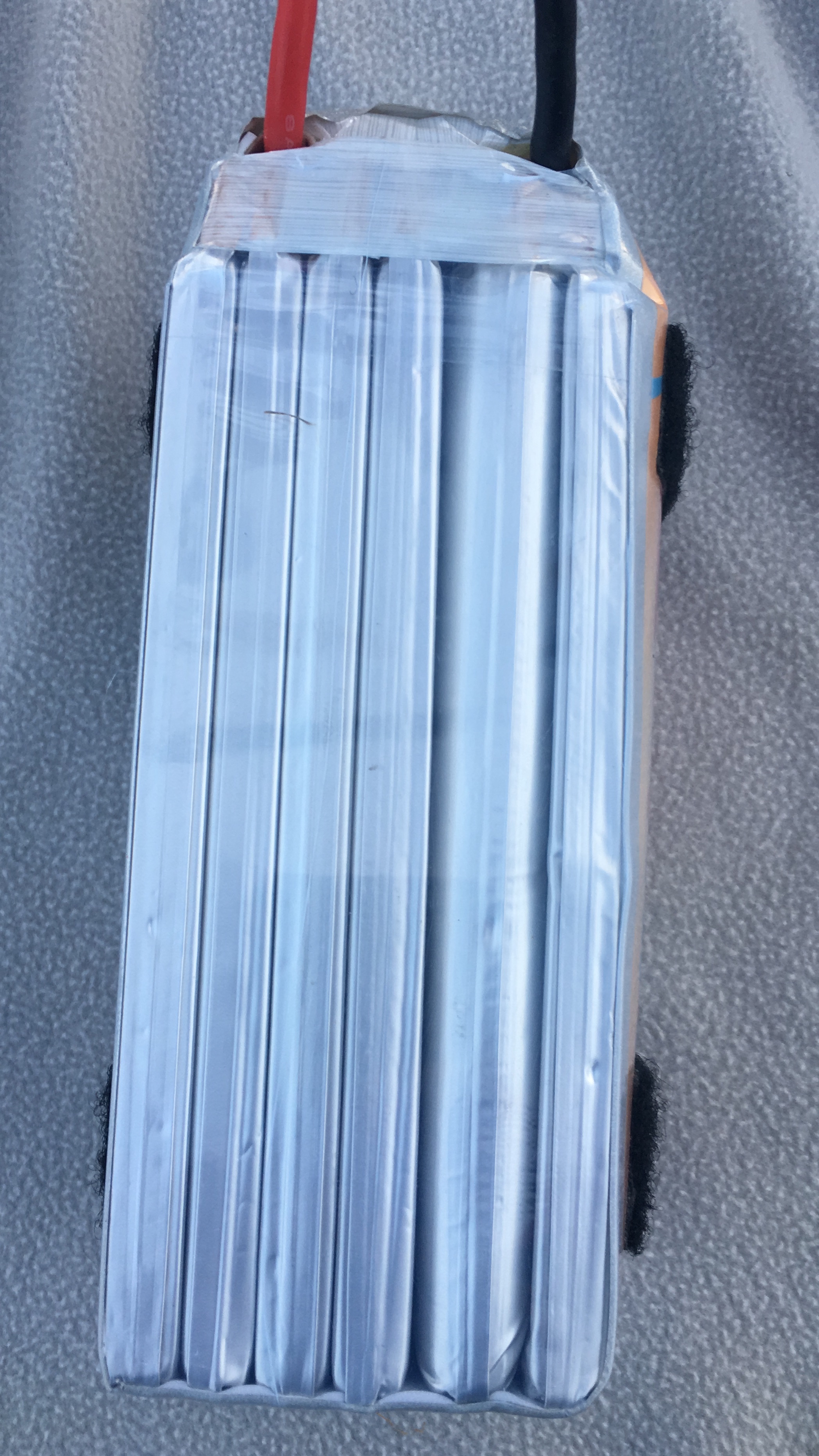

This is a long post so I’ll start with a picture of a puffy Bonka cell to perhaps grasp and hold your attention.

When I went to charge my batteries after that flight I had one cell with a voltage of 2.7 while the others were all around 3.5. Below 3.0 is considered a dead cell. But that cell quickly caught up with the others during the charge cycle and it even held a full charge at 4.2 volts. My plan was to keep an eye on it by landing early the next time I flew but I didn’t exactly stick to that plan. That was mistake number two! But at least on this flight I didn’t start with cold batteries.
When I landed I had not one but two puffy cells. Each puffy cell was in a different pack as well as in a different parallel circuit. I started the flight with one damaged cell (which wasn’t puffy) and landed with two bad battery packs with a puffy cell in each. I did not start with cold batteries and I did not overdischarge them on that flight so I was puzzled as to why would I had two puffy cells from that particular flight when this never happened after well over 100 flights. The voltage of the good cells ended at approximately 3.5 volts and the puffy cells were at zero.
After much thinking I have an explanation that makes sense. I hope everyone here already knows not to plug batteries in parallel with each other if the voltage isn’t exact the same. Doing so will cause the pack with the highest voltage to charge the pack with the lowest voltage at near infinite amps! Definitely not a good thing! I started with all of the cells at 4.2 volts but remember that one of my cells was damaged from a previous flight and therefore it probably dropped in voltage much faster than the others and eventually got puffy and dropped to zero volts. This left me with 11 cells in parallel with 12 cells. The pack with 12 cells then tried to charge the pack with 11 cells with near infinite amps until the weakest of the 12 cells puffed and dropped to zero volts afterwhich the parallel circuits had equal voltage. This left me with 11 cells in parallel with 11 cells so everything was balanced again. The damage probably didn’t quite happen in stages like I described but perhaps more simultaneously because the parallel circuits want to alway be equal.
With cells puffed up that tight, how likely are they to bust open and burst into flame? It’s a scary thought indeed!
