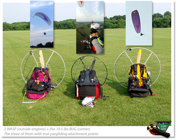

I named it the Piccolo. It was an add on to the regular PG harness - I was wearing it like a backpack. Similar to this gas one I had designed. The idea was to help during transitions and not takeoff from the ground. Without the PG harness, the whole thing weighed around 19lbs. dry. Note that it had a speed-bar, a foot-rest, a 18 to 19" semi density dorsal foam protection, side zipping pockets, and a dorsal reserve parachute with the handle places right or left, and last the connection to the risers were the same as on a paraglider without side bars because there was no frame). The whole unit could be removed from the PG harness in 30 seconds and was held in place with four 2" wide industrial Velcro straps.
The secret was the weight of the machine. We new we couldn’t go over 22/23lbs or the center of thrust would have been pointing at the seagulls.
None of those three machines had a frame. The power plants were attached directly to the harness. We could actually takeoff from the ground with those if the pilot was lightweight but again, they worked fine with heavier pilots after taking off from an elevation to sustain lift.

They do not exist anymore. They were all prototypes and never for sale. I was just having fun making them and flying them. I built about 7 or 8 different ones, all within the max 22/23lbs maximum weight. I actually approached two PPG manufacturers at the time at the Coupe Icare in the french Alps but they thought I was nuts - heavy and powerful gas units was already the norm and the direction everyone was taking. One machine had a Japanese Zeenoa engine and the PPG without fuel weighed 82lbs.
