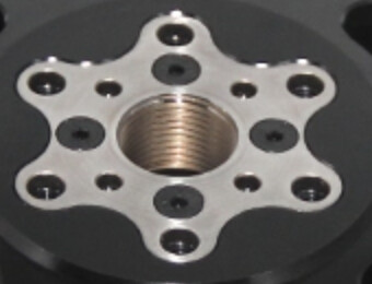

This might be a stupid question, but I just want to know if it’s possible to mount a 4 holes prop on the SP140.
I have 2 props that were used on an Air conception Hybrid 130 and I was wondering if I could use them on the SP140. Since I don’t have the unit yet and I see there are different holes on the motor plate, does anyone have tried it so far?
The mounting pattern on the MAD M50 is 6* M6 dia 50mm. It is the same pattern as the Air Conception Nitro and Tornado engines use, but the pitch of the SP140 E-Prop is closer to the Tornado than the Nitro.
Even if could fit the prop of the Hybrid 130 on the motor it would not be well suited and you will loose efficiency.
The center piece of the M50 looks like you could use 4 M3 screws and there is even a screw thread. But I doubt that this little mounting would be able to handle the torque.
The default props of the SP140 weight 575g (2-Blade) and 860g (3-Blade). You need a proper mounting when you pull full throttle. In contrast to most ICE engines the power delivery is rather instant.
